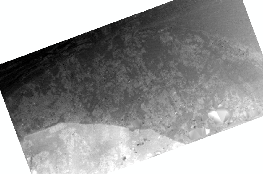

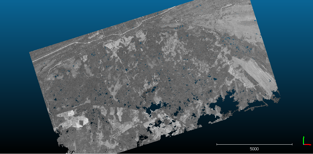

Yes, so this is how point cloud and DEM looks:
The attachment DEM.PNG is no longer available
kozolins
Posts: 11
Joined: Mon Mar 09, 2020 10:20 am
Re: Noises
Post by kozolins »
Point cloud.PNG (352.76 KiB) Viewed 15256 times
Re: Noises
And where is the noise? Can you show the cloud from the side maybe?

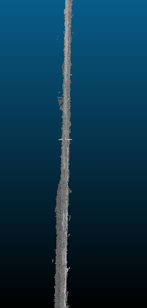

kozolins
Posts: 11
Re: Noises
Post by kozolins »
Hope you can understand from this - on the right side are negative values.
Re: Noises
Hum, I fear the noise is too dense and 'attached to the cloud'...
You could of course remove the points with negative Z easily, but I bet it's not that easy?
