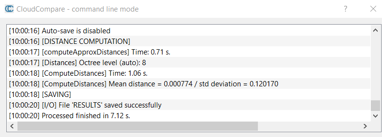

Yes. Here it is what the CC command line shows me:
command line.png (18.11 KiB) Viewed 19546 times
And the RESULT.las file is nowhere..
Re: Running CC from python terminal
Posted: Wed Apr 22, 2020 4:35 pm
by WargodHernandez
What is the result if you specify the full path for RESULT?
