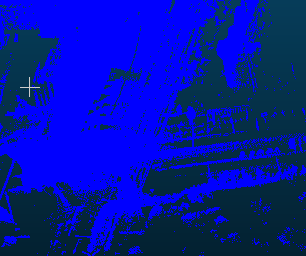

I did my job of getting coordinates in onitemoicked, but I ran into a problem.
When I adjust the scalar, click on my plug-in to select the mouse point function, an exception occurs, the point cloud color disappears! The scalar is still the one I set. When I set the scalar again, the scalar will not be abnormal again.

Thank you for your answer, we solved this problem, and we found that on the first click, cc created a scalar called "octree_picking" for the point cloud.
