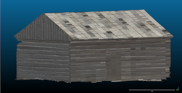

I have quite a few data sets that have UTM coordinates in the range that exceed 500000.00,4390000.00
When opening any file with coordinates in that range, CloudCompare offers to offset.
[17:19:11] [PLYFilter::loadFile] Cloud (vertices) has been recentered! Translation: (-506228.12,-4394878.00,-1641.74)
It appears that coordinates that exceed 4000000.00 and probably 1000000.00 exceed some limit and are truncated or rounded to the nearest 0.5 unit - in this case meters. Probably goes unnoticed for many data sets but for a building in those coordinates it is pretty obvious.
Thanks for all your wonderful work.
Tom

- Screen Shot.png (212.62 KiB) Viewed 21529 times

Indeed CloudCompare works with 32 bits floats which have a relatively limited accuracy (this is why if we detect coordinates above 1000000 we warn the user).
What bugs me is that we precisely do this to avoid losing 'short scale' accuracy ... So you shouldn't get this round off effect. Moreover the PLY format handles double precision (64 bits) so it should also be ok.
What is the software that has generated the PLY file? Can you send me a sample file so I can investigate this effect more deeply? (cloudcompare [at] danielgm.net)
