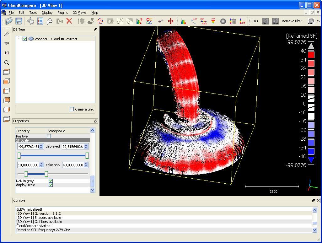

here is a first peak on the new 'color scale' system.
- I've found very neat widgets to handle intervales (Qxt library 'SpanSlider' - libqxt.org). It should help to better understand how the sliders work.
- I've added options in the 'Display settings' dialog to handle the color scale display and behavior (squares size, text size, 'always display 0', and 'always symmetrical' - this last one is forced for the moment as I didn't had the time to change this last point - the new release will come out as soon as this is ready)
- there's a new color ramp named 'Blue>White>Red' as you suggested (I juste kept the convention: blue for minus (cold) values and red for positive (hot) values)
- as the color scale is not always linear, I've added a new type of square (a slashed one) to indicate the ones that have not the same span as the others
In this new version of CloudCompare you'll also be able to rename de scalar field. I'll try also to make CC rembember the SF name when the cloud is saved as a 'bin' file.
EDIT 09-04-2011: the last version is out. You'll find everything you need in it!

- New CC color scale system
- cc_new_color_scale_system.JPG (143.7 KiB) Viewed 36401 times
