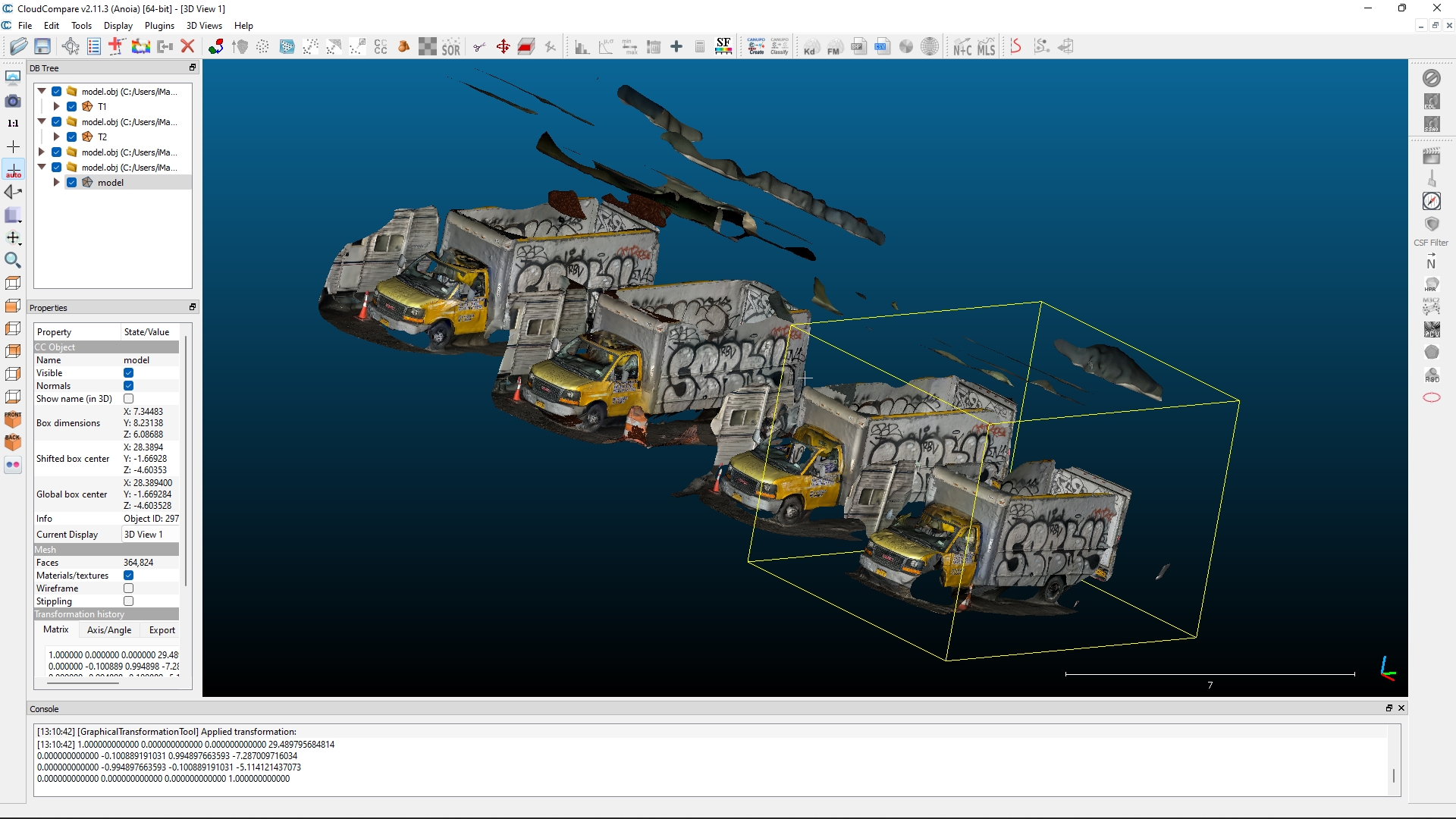

I have several scans that I've captured using a mobile phone photogrammetry workflow. And I'm looking for help with the best method to perform a merge in cloud compare, that combines the very best from each of these scans into one model.
Should I be trying to sample each scan for points before merging? How can I filter outliers? Is there a way to preserve the color information? And is there a way to perform a merge that starts with the most complete scan - using the other scans to fill only the data that is missing?
I'm interested in maybe using filtering tools to isolate areas that are missing from my most complete scan. Or maybe there's a way to apply weighting to the merge that prioritizes the data values from one scan over the others? Can scalar fields be useful in this type of merge workflow that understands the deviation between models? And lastly would computing the octree help for this merging?

Ah, that's a huge topic ;)
Here it seems you have meshes... CloudCompare is not super strong with meshes, especially when it comes to merge them. But meshes are good for registration!
So I would:
1) keep one mesh as is, and use it as reference to register the others (the widest I guess)
2) sample a lot of points on the others (Edit > Mesh > Sample Points). Keep the normals and the colors when doing so.
3) manually move the clouds so that they are roughly aligned with the reference mesh (see https://www.cloudcompare.org/doc/wiki/i ... sformation)
4) Use the ICP tool register each cloud with the reference mesh. You can first segment the clouds so as to remove the obvious outliers. But you can (and should) also set a rather low 'Final overlap' parameter so as to indicate to CloudCompare that not all parts of the clouds have correspondances in the reference mesh. Something like 70%, looking at your screenshot.
5) Once all the clouds are registered, you can now sample points on the reference mesh
6) Merge all the clouds
7) Segment the merged cloud if there are still parts that you don't want
8) Finally, use the PoissonRecon tool to re-mesh this cloud (to fill the holes, etc.). Make sure to output the 'Density', so as to control the resulting mesh extents and hole filling (see https://www.cloudcompare.org/doc/wiki/i ... n_(plugin))
And I realize that maybe the main drawback of this method is that the colors on the resulting mesh will be now per-vertex colors, and not textures. Which might not be managed by the other software tools you might use!
