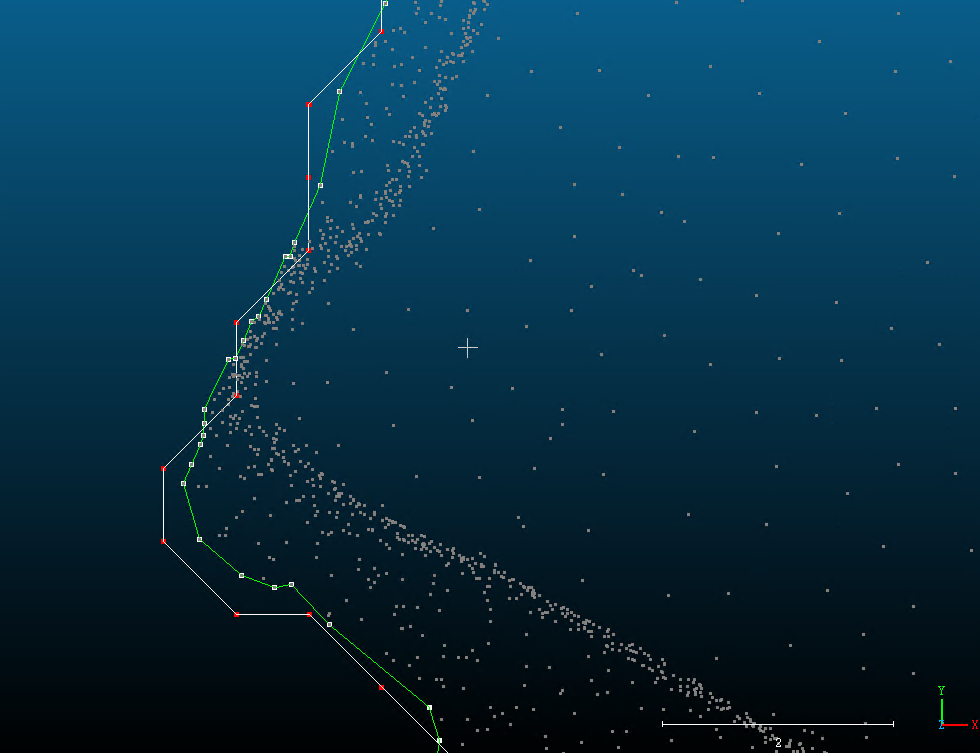

Sorry, I haven't made my problem clear. I upload the result in the attachment. The envelop (green line) is extending into arbitrary directions, while the contour (white line) goes in several regular directions. I think you mean this is caused by the gridding calculation of the contour, is that true? Thanks.
Re: Cross section for multiple slices
Yes, the 2 methods have very different ways of working. One projects the points inside a plane and use an expansive algorithm to try to determine the concave hull, and the other simply relies on a regular grid (just as the 'Rasterize' tool).
