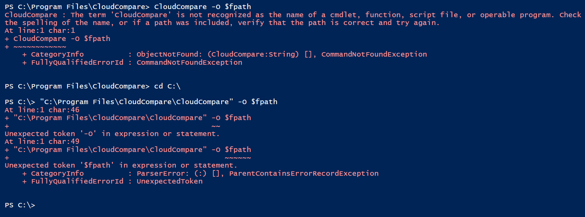

Hi everyone,
I'm attempting to write scripts in the powershell ise to automate some CC functions and I'm running into some difficulties. I was able to open clouds using the command line, but when I try to run any CloudCompare functions in powershell I am getting errors. Has anyone had issues with this or been able to run command line through powershell successfully? I've tried it from the cloudcompare directory itself and from the c drive using the longer path and neither method is working though both ways works using cmd terminal (screenshot attached). Any advice would be appreciated I'd much rather use PS if possible, thank you!
Cheers,
CM

To start a process like that in PowerShell you have to add a `&` at the beginning.
&"C:\Program Files\CloudCompare\CloudCompare.exe" -o $path
Or you can use Start-Process
Start-Process -Wait "C:\Program Files\CloudCompare\CloudCompare.exe" -ArgumentList '-o',$path

Post by cmackSIO »
Great thank you, I've been able to get this working, apologies for the rookie questions, I'm learning powershell as I go along with this project - I appreciate your help!
