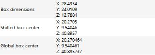

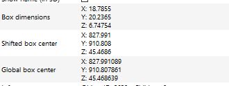

Indeed, the transformation applied is a 4x4 matrix. I maid further test to have a better understanding of the behavior of CC when transforming with a 4x4 matrix.
Because it can reproject natives locals coordinates based on GCP in global coordinates, we use the "Align" tool.
A 4x4 transformation matrix is produced after this Align process. This matrix could be used to reproject the other parts of the same scan but, it appears to be applied to the shifted box center and not to the global box center. So data are projected in the same local space, with different global coordinates. Witch make a significant difference for third parts softs using others importing methods.
To illustrate those differences, I roughly georeferenced a e57 structured data set available here https://webimaging.lillemetropole.fr/ex ... _scans.e57. It is composed of :
Sorry for the delay for this response.
- "align_point_picking" set has been georeferenced using the Align tool (properties in the first attachment),
- "align_mat4x4" with the 4x4 matrix (properties in the second attachment)
0.983088016510 0.172502502799 0.061488993466 799.030822753906
-0.173136740923 0.984884619713 0.005099871196 905.169494628906
-0.059679824859 -0.015659626573 0.998094797134 1.418987154961
0.000000000000 0.000000000000 0.000000000000 1.000000000000 - "original1", "original2" and "original3" are native parts of the local registered data set (properties in the third attachment).
- Properties of the set georeferenced with the align tool
- cc_propr_georef_point_pick.JPG (14.24 KiB) Viewed 3538 times
- Properties of the set georeferenced with the 4x4 martix
- cc_propr_georef_mat_4x4.JPG (14.86 KiB) Viewed 3538 times
- Properties of an original set in local coordinates
- cc_propr_original1.JPG (13.57 KiB) Viewed 3538 times
