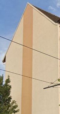

So, the plans found in RANSAC are always limited as a square, right?
I mean, if there is a wall whose projection in elevation is not a square, like the picture attached, the RANSAC function creates a square plan which containts all the alligned points (total height and total widht) but it doesn't fit to the sloping edges. Do you know any method or any software that could help to delimitate the plan with the actual outline?

In CloudCompare, once the Ransac SD plugin has detected planes, the plugin also creates individual clouds that correspond to each plane (with the plane entity attached to it). You can select this cloud and fit a 'Facet' (Tools > Fit > 2D Polygon (Facet)). CC will try to detect the contour and it can even extract a concave contour (with you set a small enough 'max edge length'). This 'Facet' entity is composed of a contour (polyline) and a 2D polygon as mesh. This might be helpful to you?

Yes, that is exactly what I was looking for!
