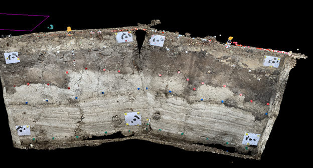

Hello
Thank you for the prior responses. I'm having difficulty with the sides of the unit overlapping at the bottom of the units. I'm creating one polyline at the top of the unit and unfolding it a distance of 1m. I've attached an image of the result. Any suggestions would be appreciated.

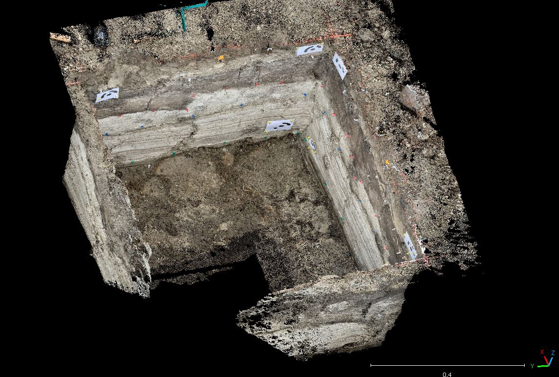

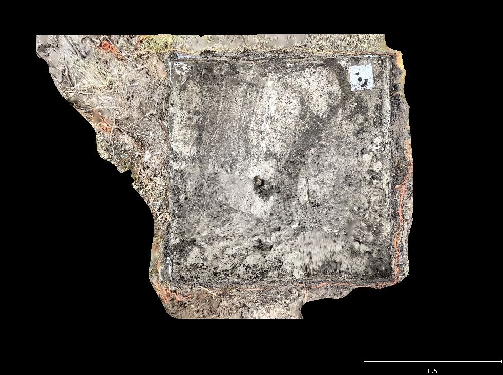

Post by Kate3388 »
Hi, I've attached a few images. Thanks for looking at this and if you need anything else, please let me know.

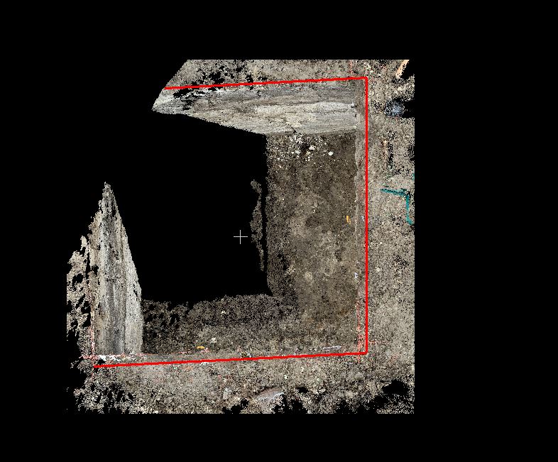

Re: Unroll other shapes
Post by Kate3388 »
Yes I can and that is the position that I had the point cloud in when I created the polyline. I've attached an image. The tool is now also grey out and not available I have selected it in the DB tree. The target in the image is on the bottom of the excavation. There are also several targets on the sides of the excavation pit so that I can in a additional step georeferenced the images.
