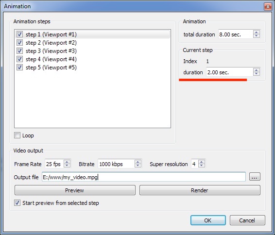

Dear Daniel,
Can I set my camera in a constant speed?
(I mean when the camera pass through the same length, It will spend the same time.)
Thank you so much!

Re: Animation: Can I set my camera in a constant speed?
Post by Morris »
you can set the duration of every steps in the render dialog.
choose the view point and set the duration.

In animation child window ,How to use ctrl + A to select all viewports to assign i.e. 2 sec for all?
That's not possible currently.
But you can change the overall duration of the animation, and it will change all steps in a proportional way I believe.
