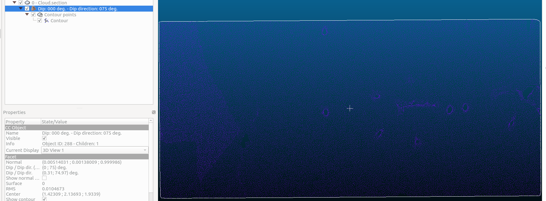

Trying to convert point cloud (PLY) to meshes (OBJ) by using Tools>fit>2D polygon (facet). However, able to obtaining only Contour points and not 2D polygons.
Using version CloudComapre 2.12.0(Kyiv). Can someone help me out on how to obtain the 2D Polygon so, I can export as mesh?
Not sure if I am missing something. Tried the steps and went through the forums, however, cannot figure out how to fix this?
Thanks in advance for your time.
Screenshot from 2023-01-31 10-05-23.png (191.42 KiB) Viewed 1833 times
Re: 2D Polygon Facet [No polygon only contour points]
'Hum, is it because of the LoD mechanism maybe? (= only at display time)
You can try to disable the option named 'When moved, decimate meshes over XXX triangles' in the 'Display > Display settings' menu.
