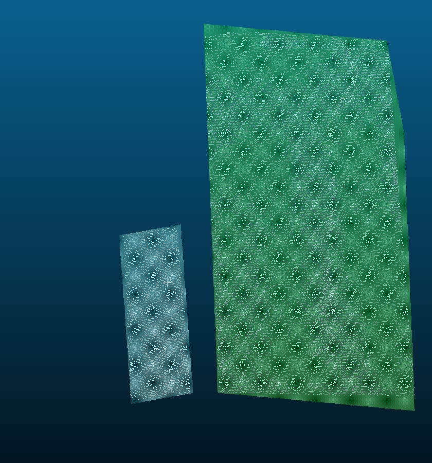

Hello everyone.
I have two point clouds which are supposed to represent planes. Now I want to intersect these two planes to get the intersection edge and measure the length of it. I have tried every function of CloudCompare to solve the problem. I do not want to succeed in intersecting the two point clouds. Also via Edit>Plane>Fit I do not succeed in cutting the created planes.. I am looking for a solution for two or three planes.
Does anyone have a solution for this problem?
Screenshot 2023-03-22 134917.png (97.17 KiB) Viewed 2101 times
Re: Cutting two/three Planes in CLoudCompare
The only way to cleanly cut a plane is to use the 'Tools > Segmentation > Cross section' tool. But that's a manual operation...
