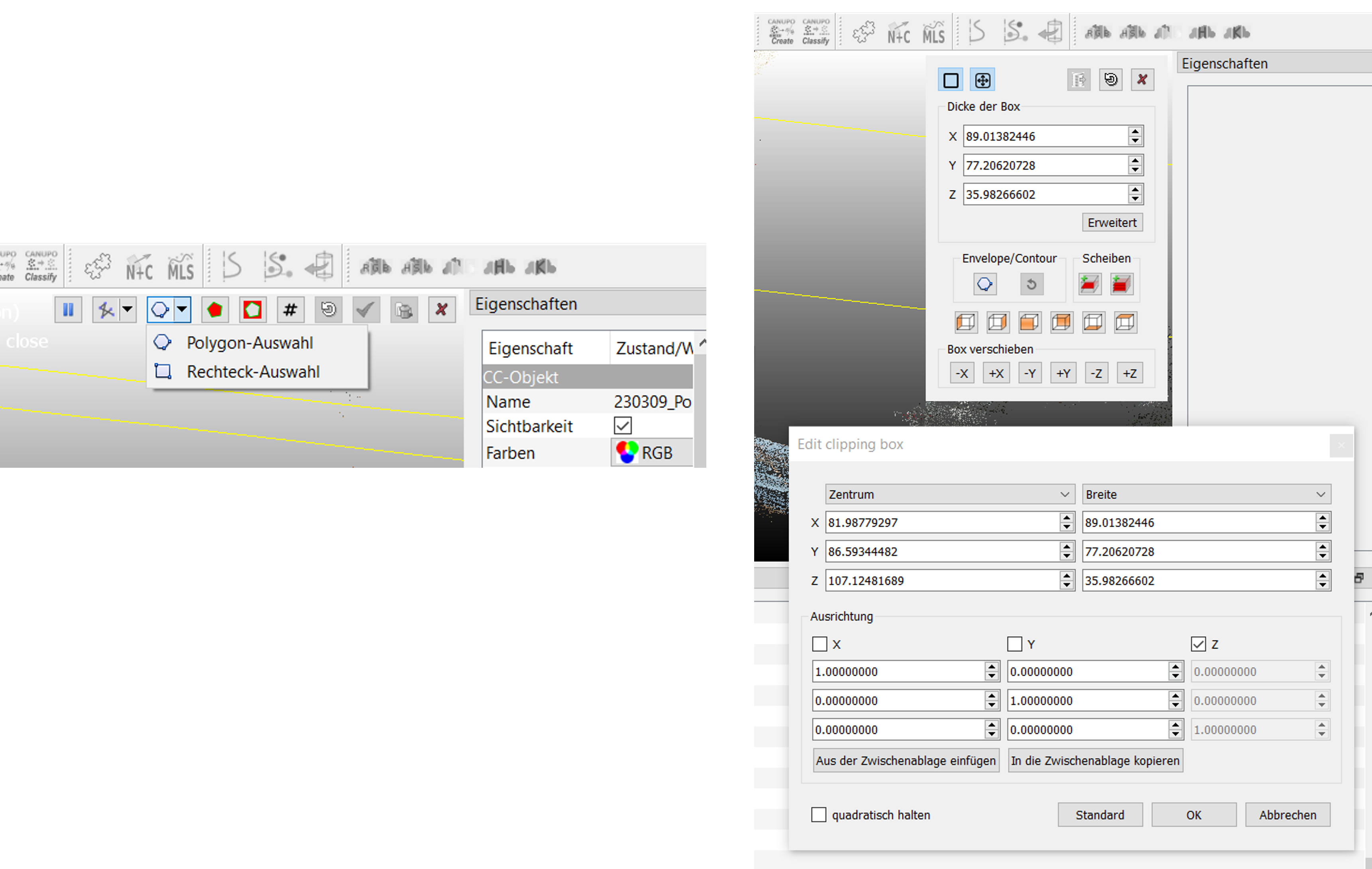

Hello Daniel,
is it or would it be possible to implement a combination of the two tools?
I want to clip a point cloud based on a given surface (list of coordinates or polygon). If no, do you have an idea, how it could do that manually?
