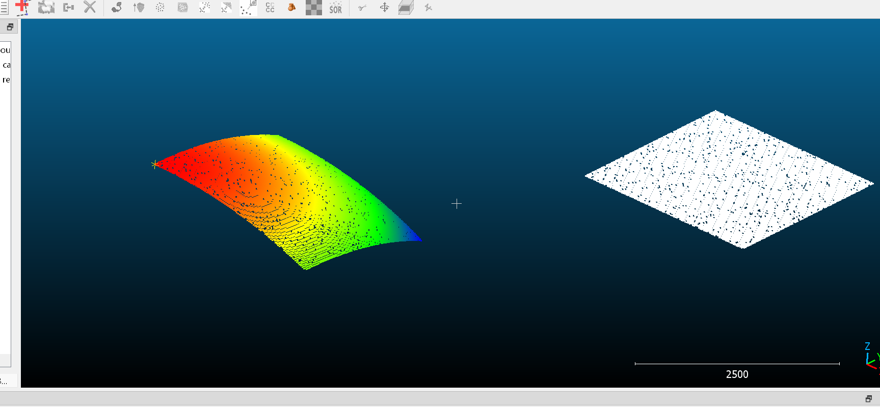

Re: Convert vertical datum in CC
Posted: Fri Jul 28, 2023 10:20 pm
by DA523
attached 3D pointscloud example
Screenshot (146).png (79.51 KiB) Viewed 17060 times
check CC file below
2500km.zip
(246.59 KiB) Downloaded 1907 times

Let have these UTM coordinates (xyz in m) from a ship GPS log
x,y,z
468286,4082477,0
467995,3981250,0
467704,3880024,0
467413,3778797,0
467121,3677571,0
466830,3576345,0
466539,3475118,0
466248,3373892,0
465957,3272665,0
465665,3171439,0
465374,3070213,0
465083,2968986,0
464792,2867760,0
464501,2766533,0
464209,2665307,0
463918,2564081,0
463627,2462854,0
463336,2361628,0
463044,2260401,0
462753,2159175,0
462462,2057949,0
The real shape of ship track is ARC not straight line because earth curvature
GPS use z referenced to sea level (curved )
Because CC uses Cartesian coordinates ,it shows as straight line not curve line
Is there any existing software,lib which prepares utm to Cartesian so CC can show real curved line ? GDAL ?
