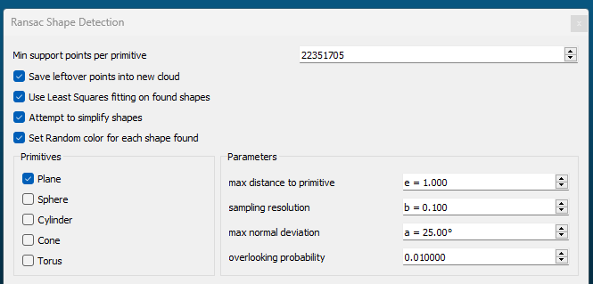

i wanted to run RANSAC with following information. Unfortuentely I get the message "[qRansacSD] Segmentation failed..."
What is the problem here? It ditd work with 15 mio points, but not with 22 mio points. Why?
Would it be possible to define smaller sampling resolutions like 0,0014950m?
Regards ands thanks in advance!
Thomas

Generally it's related to the 'minimum number of points per primitive'. If it's too high, it's likely that the algorithm failed to find a set of that many points that respect the other constraints. Can you try with a lower number of points?

I am using the RANSAC algorithm in my research. In the research, I am investigating different sets of support points (0.01, 0.1, 1, 5, 10, 20, 35, 50, 65, 80, 95) with the question of which % are enough to find the primitive of a plane. By 50% the algorithm fails.
Would you agree to the following:
  • Decreased Robustness: RANSAC is usually robust because it randomly samples data points to estimate the primitive. However, when I demand a high minimum number of inliers to declare a hypothesis (my plane to be found) as valid, it reduces the algorithm's robustness. It's more likely that no subset of points will meet this stringent criterion.
  • Trade-off with Data Density: The required percentage of points for support directly depends on the density of my data. I do have a sampling resolution of 0.0015m/pix. In sparse data regions (which I do not really have), it can be challenging to find enough points to satisfy the minimum requirement, leading to algorithm failure.
  • Underlying Complexity: The RANSAC algorithm assumes that the data can be described by a particular model (in my case, a plane). If I set a high minimum number of points per primitive, it means I am assuming that the underlying data can be well-described by a complex model (one that requires a large number of points to define). But it does not work with other 50%.
So why does the algorithm fail in your opinion? I do not see any problem with the other constraints. The point cloud has a sampling resolution of 0.001495m/pixel, I do use 0.001 as smallest number. The max distance to primitive is 1.00m, but the cloud of the plane is actually only ~0.20m wide.
Re: RANSAC segmentation failed
Hard to say without looking at the data... I managed in the past to get a result with much more than 50% of supporting points (but of course, that would be on a cylindrical cloud when looking for a cylinder for instance). Most of the points must be part of the primitive that you look for.

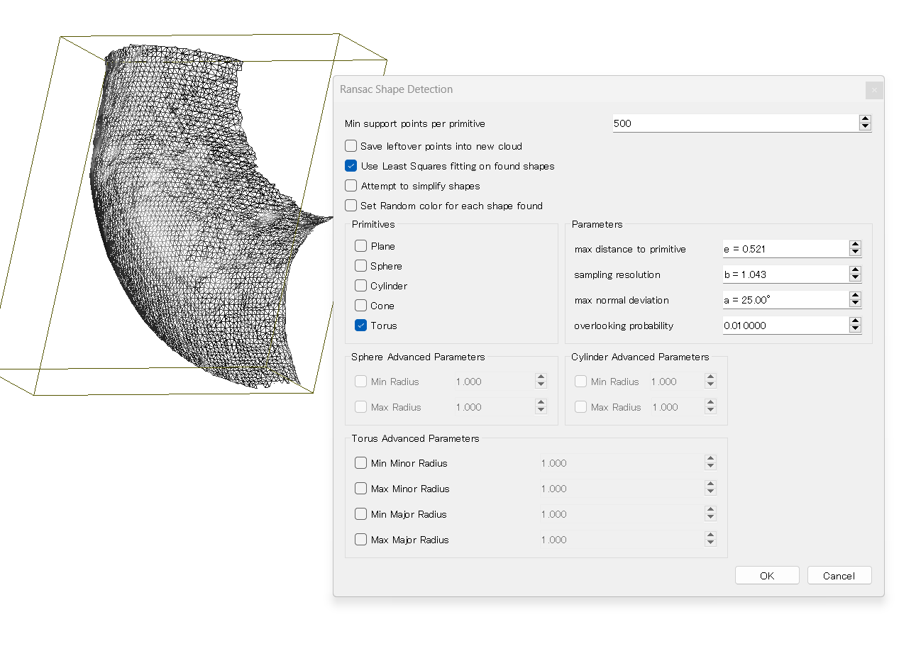

I tried to generate a torus to match with the measured elbow (part of pipe).
I got an error message "segmentation failed".
This error message appears for any other shaped that I tried.
segmentation failed for torus.png (164.54 KiB) Viewed 16682 times
Does anybody have an idea what is wrong with my settings?
I appreciate getting any hints.
Best regards,
MINORU NIIMURA, Tokyo, Japan
Do you have enough vertices/points in the selected cloud? Because a minimum of 500 points may be too much compared to the total number of points?
Otherwise, don't hesitate to send me the cloud (to [email protected]).
Thanks for the data.
I can confirm that it fails on my side as well when trying to detect a torus... I'll have to look at what happens at a lower level in the code. It may take some time.

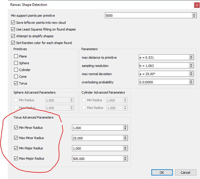

So it seems that one has to set the min and max radius parameters to be able to extract torus shapes... I'll try to fix this in a future release.
Meanwhile, just make sure you specify some realistic values:
