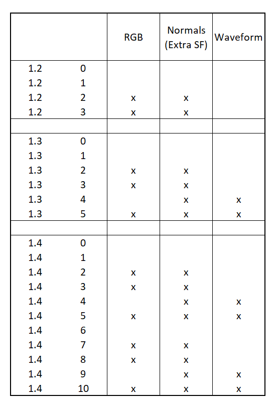

you are right! Depending on the version of the LAS file the different options are activated, in particular I was getting the default version 1.4 sub 6 which doesn't allow colour and extra field, changing to sub 7 works. I attach if needed for other users the complete table for colour, extrafield, waveform support.

So by default, did CC chose the point format 6 while there were some colors on your cloud?

this is a cloud with assigned color inside CC. Original was 1.4 sub 6, but after addinc color don't promote to sub xx during saving with supported color.
