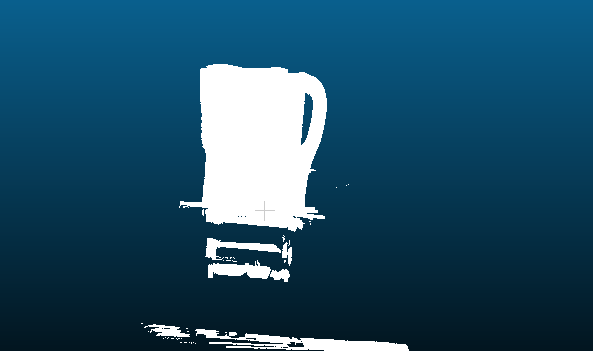

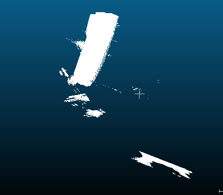

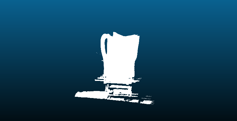

Daniel, I'm going to share the images I got from a test I did, they have a front, side and back view and what I wanted was to learn how to fill in the back, instead of it being the way it is.
From The sides.png (6.27 KiB) Viewed 4907 times
Re: Laser Scanning and 3D Reconstruction.
Well, it's hard to see (don't hesitate to activate the EDL shader ;), but assuming you have some overlapping surfaces, you can indeed use the Edit > Translate/Rotate tool to roughly align the scans, and then use the ICP tool (see https://www.cloudcompare.org/doc/wiki/i ... gistration)
