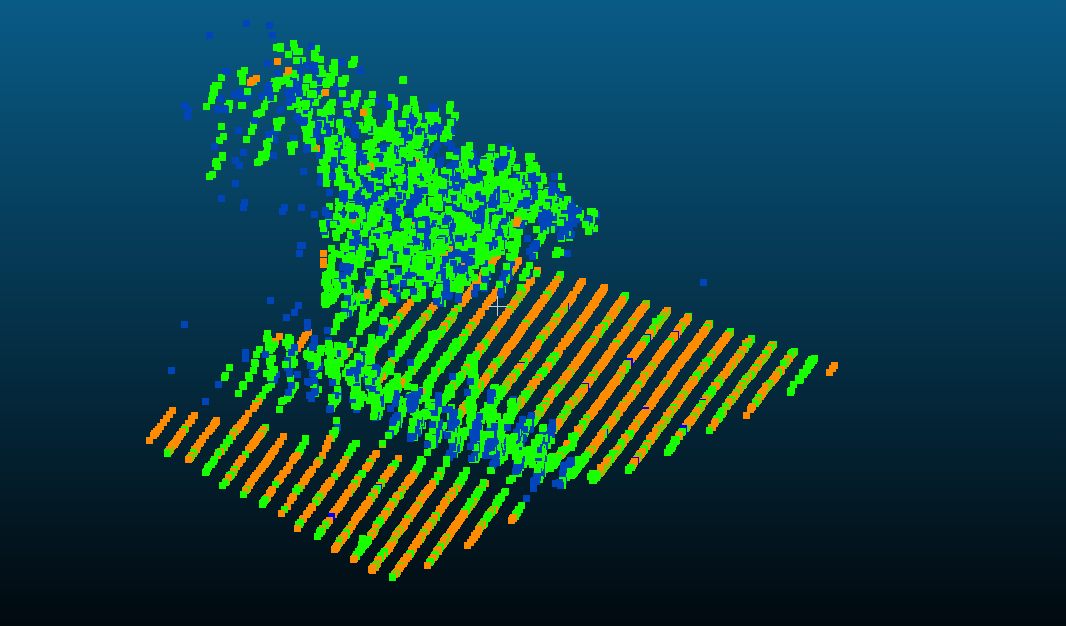

I am classifying point clouds using the following command :
" .\CloudCompare -c_export_fmt LAS -ext las -o "micro_cloud.las" -3dmasc_classify "vsimple.txt" "PC1=1" -save_clouds "
The LAS file obtained rearranges the points on lines (see screenshot) :
Do you have an idea why ?
Is there a way to spot the issue or fix the problem ?
Thank you
Re: Command line classification
Yes, that's because with the command line you need to explicitly specify how to manage large coordinates.
You should add
-GLOBAL_SHIFT AUTO
just after
-O
sjurado
Posts: 14
Joined: Tue Jan 09, 2024 1:57 pm
Post by sjurado »
It worked ! Thanks
