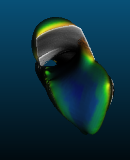

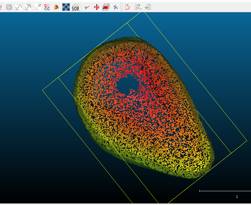

Hey guys,
Guys, I have this point cloud (see image 1) with these holes and I want to create a mesh of it.
So when I create a mesh, cloudcompare fills these holes automatically(see image 2) and I don't want that, and I wanted to know if anyone here knows how to solve this problem.
Thank you.
