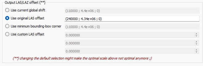

This reply indicates that the function does not behave as I intended. My goal is to preserve the offset of the original file in the resulting file, i.e., to select the option shown in the attachment.
With this code, my aim is to save a file identical to the original but with the normals added as a scalar field. How can I do it?

With the option that you indicate to me, the offset in the metadata is still changed. These are the original metadata:
And these after calculating the normals:
Re: Using the option "-KEEP_ORIG_FIXED" in the commandline
And if you do it wit the GUI version, is the default Global Shift equal to the original LAS offset or something else?
Looking again at the values in your screen capture, it seems that the automatically generated offset is 10^5 smaller. I guess CC estimates it's too large to maintain accuracy. Once again in the GUI version you could change the threshold (with 'File > Global shift settings'). But you cannot do that with the command line version. It would be easy to add though. Or add an option to explicitly force the use of the LAS offset maybe.
