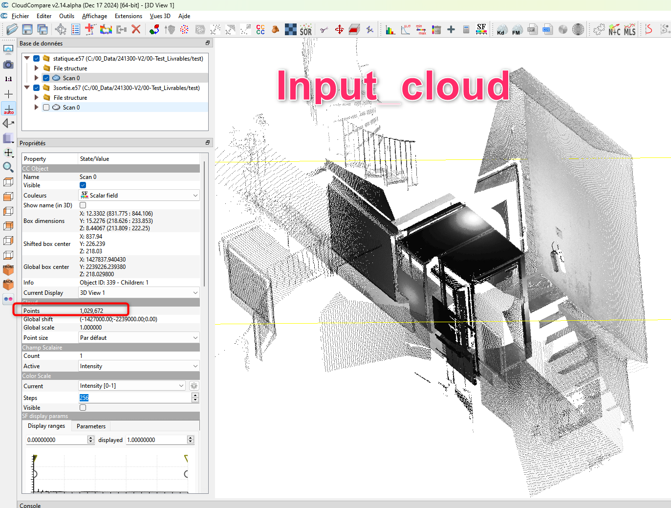

I am facing a strange issue with a point cloud and CloudCompare. Let me explain with a simple example:
I have a point cloud, which I’ll call "input_cloud".
I perform a simple process in CloudCompare via command line: I load the file and then export it. The exported file becomes "output_cloud".
The problem:
When I display "output_cloud" in any software, it visually appears as if the cloud has been decimated or downsampled. It is no longer a dense point cloud but looks like a grid of points aligned vertically, with bands spaced 50 cm apart.
However, the total number of points in "input_cloud" and "output_cloud" is exactly the same, and the file sizes are almost identical.

Yes, that's the very classical 'Global shift' issue. While CloudCompare will warn the user of the Graphical Interface version profusely, it doesn't apply any global shift to large coordinates by default in the command line mode.
You have to use '-GLOBAL_SHIFT AUTO' just after '-O' at the very least. See the wiki: https://www.cloudcompare.org/doc/wiki/i ... _line_mode
