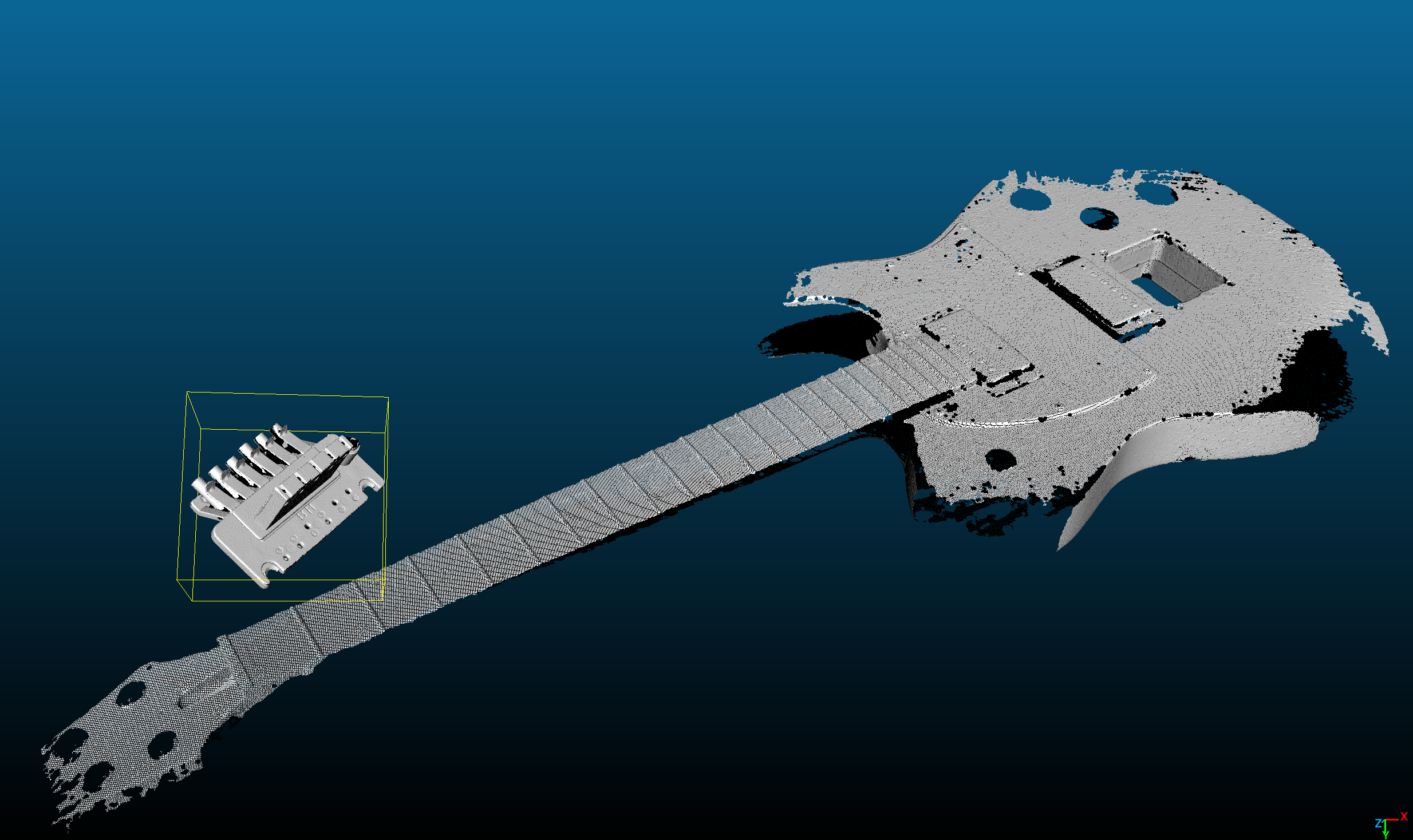

Here is a screen shot of what I am trying to do.
There is a point could scan of a guitar and a scan of the guitar bridge (in the yellow box).
Screenshot 2025-04-15 at 10.45.32 PM.png (1010.75 KiB) Viewed 11628 times
Is it possible to move the bridge in the correct place on the guitar?
Thanks.
Posts: 8207
Re: Assembling objects in CloudCompare
Well, yes, but mostly manually. Use the 'Edit > Translate/rotate' tool.
See https://www.cloudcompare.org/doc/wiki/i ... ation_Tool
I don't think registration/alignement tools will be very useful (apart maybe for the point pair picking tool... see https://www.cloudcompare.org/doc/wiki/i ... gistration)

Thank you very much. This is in fact very helpful.
