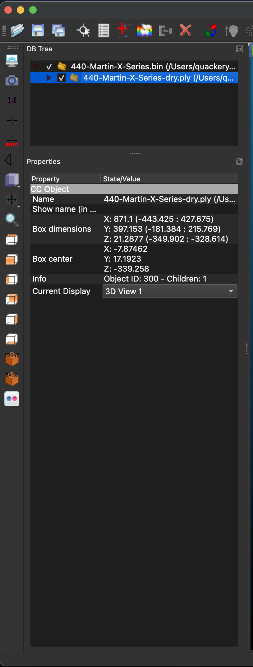

Hi all,
For whatever reason whenever I open a saved .bin file my properties no longer show up with the usual complete list of properties. What I see is this.
Screenshot 2025-04-19 at 9.45.49 PM.png (298.55 KiB) Viewed 8546 times

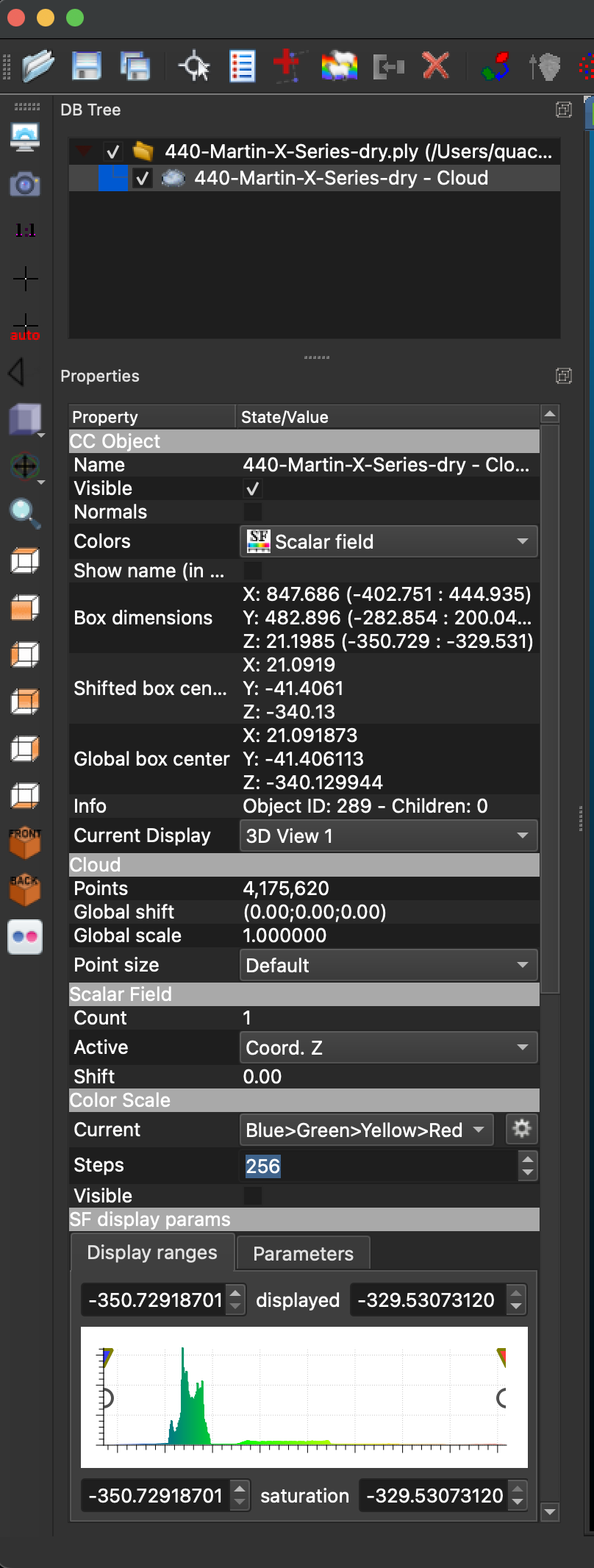

But when I open a .ply file I see a full list of properties, like this.
Screenshot 2025-04-19 at 9.46.41 PM.png (189.16 KiB) Viewed 8546 times

Re: Properties Not Showing up Fully
In your second example, it's the folder/group entity that is selected. Not the clouds or meshes inside the group. Hence the fact that you don't see a lot of properties...

Oh, I see... Thank you...
