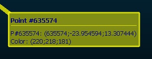

The Point Picking tool display box in Version: 2.5.3 [Windows 64 bits] should show # "point number"(x,y,z) values but instead displays the # "point number"("point number",x,y). The point number is displayed instead of the x value and x value instead of the y value and y instead of the z value.

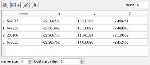

I can't reproduce the bug... Here is what I get:
Can you post a snapshot?

My bad, you were referring to the simple point picking tool which spawns "2D labels"... I acknowledge the bug ;)

Should have added a snapshot to make it clearer!

This one just got me. It appears to affect both the label and property display of points and vectors picked with the simple point picking tool. I don't presently see a way to get the actual coordinates of my vectors.

Yes it has already been reported (and fixed in the trunk version).
Have you tried with the "point list picking" tool?
