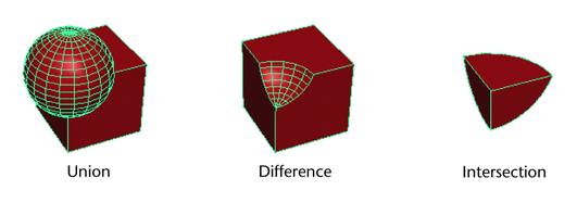

Would it be possible to add some boolean operations (Union, Difference, Intersection) with meshes.

Ok, CC has now a CSG-capable plugin based on the Cork library:
http://www.cloudcompare.org/doc/wiki/in ... PluginCork
The latest release (2.6.0) now incorporates this plugin.
