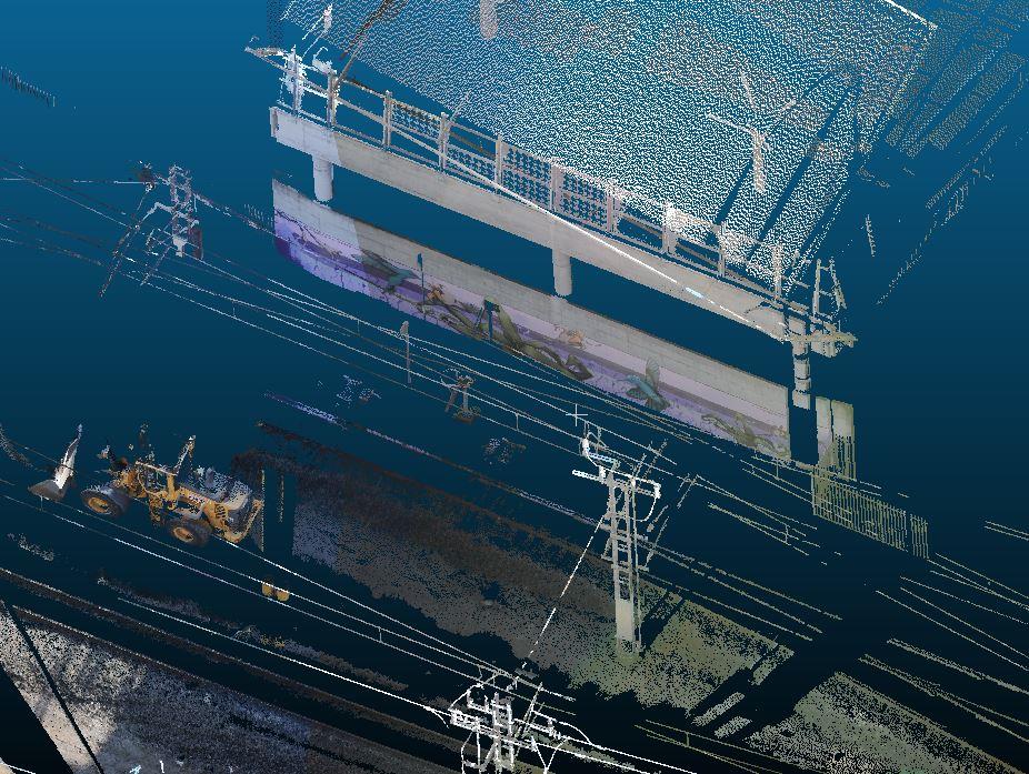

I've been trying to use the command line to merge a heap of clouds but i've been getting some weird effect. I eventually just tried opening a cloud and saving it again with the command line and i still get the same problem.
Has anyone else experienced the problem in the images below?

This looks like an accuracy issue... I guess your original file has very big coordinates? Does CC bothers you when you try to load the file the normal way?
In command line mode, CC won't bother the user about very big coordinates (as we try to avoid any user interaction). But it's clearly a problem here as you lose a lot of numerical precision when loading the file(s) without apply any temporary shift. Not sure how to handle that in the command line mode though... Maybe using a flag to tell CC to try to handle this "automagically"?
Re: Command Line Use
Ah i thought something like that might be the case. The file does have very large coordinates, cc opens it ok but always asks for a global shift.
Is there a way to force it to shift from the command line?
I'm going to add an option to handle this via the command line mode. I'll post there a beta version as soon as it's ready.
