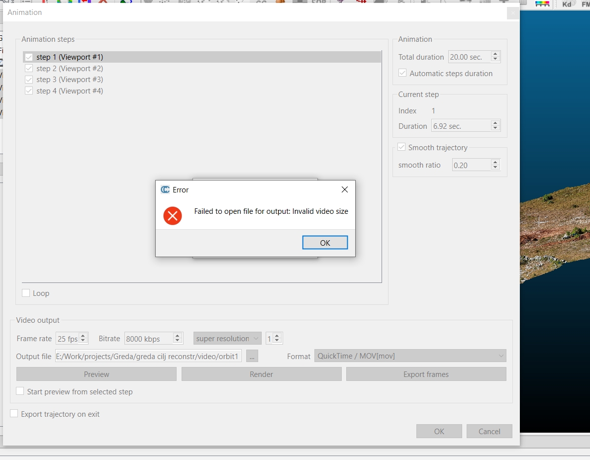

video cloud compare.jpg (209.53 KiB) Viewed 21777 times
Preview is working ok, Export frames is working also, but when you click Render, that message apperas
we tried with MOV and other video formats, same message.
frames can be exported and processed in third party software, but it would be much easier if Render work
